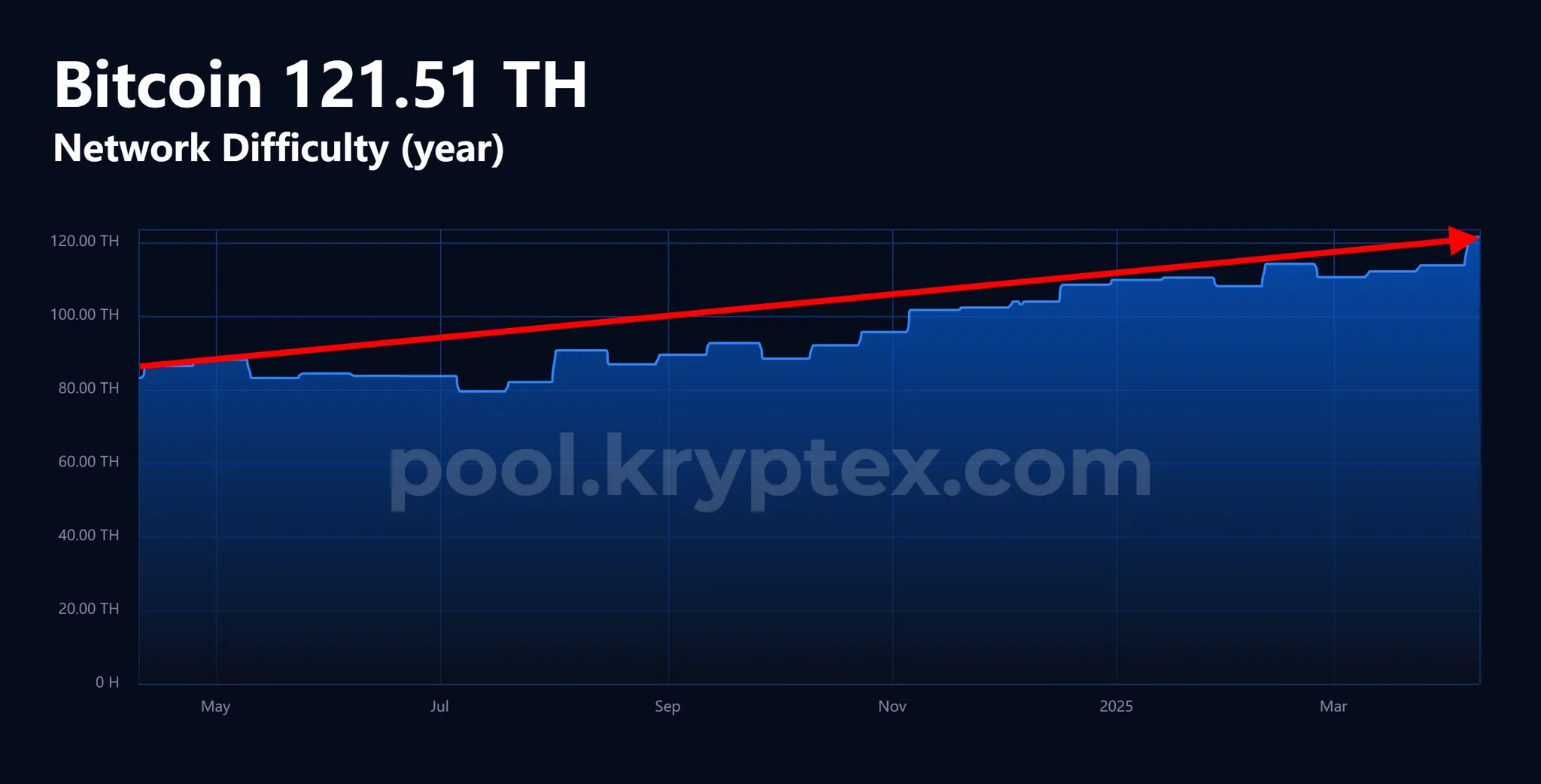

Calculation Difficulty — Network Difficulty ➗
Earlier, we have mentioned that blocks are found at fixed intervals.
But how is this achieved? After all, the more miners join the search, the faster new blocks should theoretically be found.
That's correct. To prevent this from happening, the network automatically increases calculation difficulty when there are too many miners. This adjustment maintains a steady emission rate — the creation of new coins.
The higher the calculation difficulty, the less efficient your hardware becomes, which results in reduced profitability.
For instance, the Bitcoin network's difficulty is so high that even the most powerful GPUs barely produce any significant income. This is why specialized ASIC miners are used for Bitcoin mining.

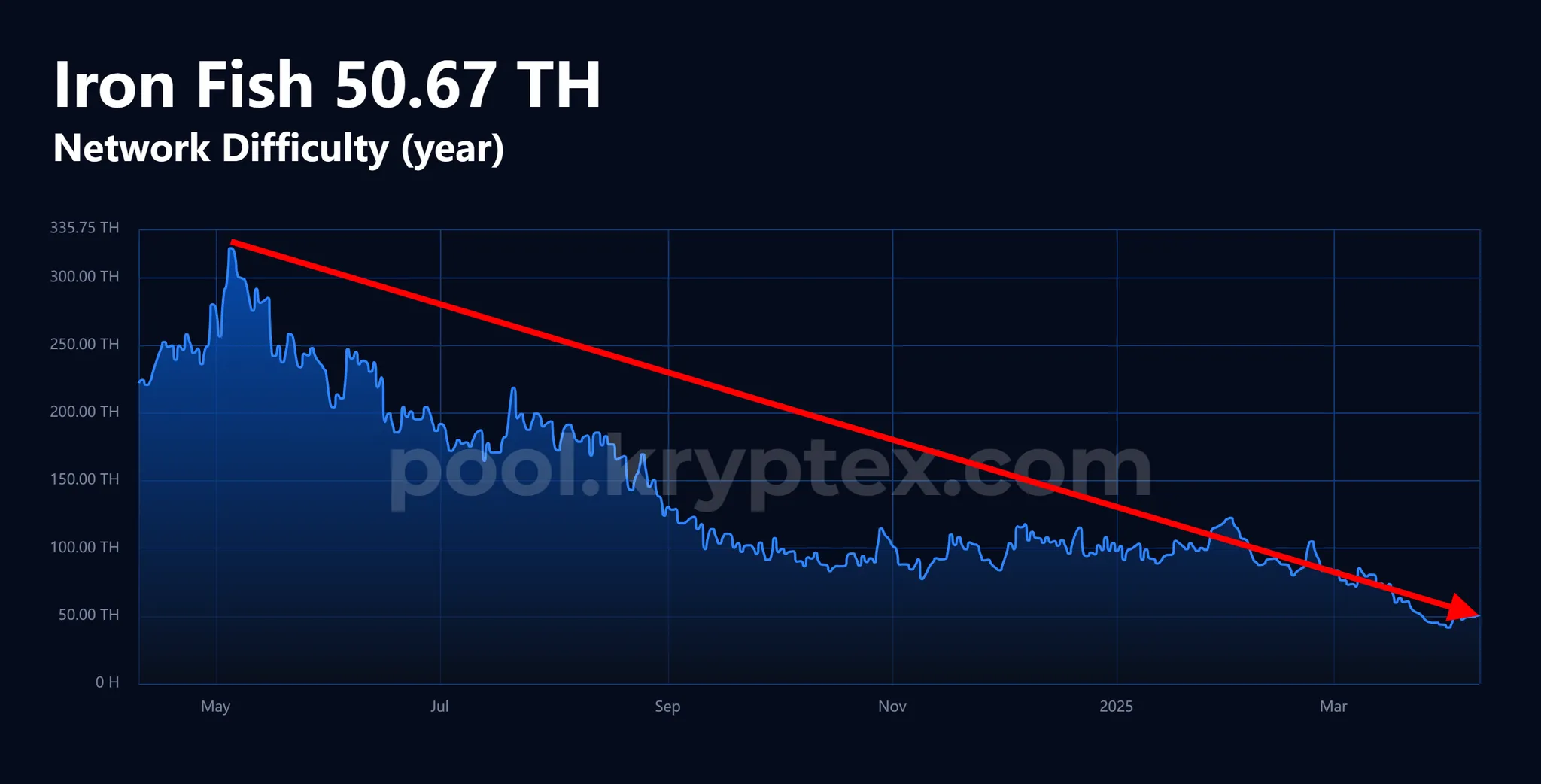

Network difficulty directly impacts the number of mined coins:
  • Difficulty Increase: If network difficulty rises by 15%, miners using the same hardware will mine 15% fewer coins over the same period.
  • Difficulty Decrease: Conversely, a reduction in network difficulty—such as due to a drop in the network’s overall hash rate — leads to an increase in the number of mined coins.

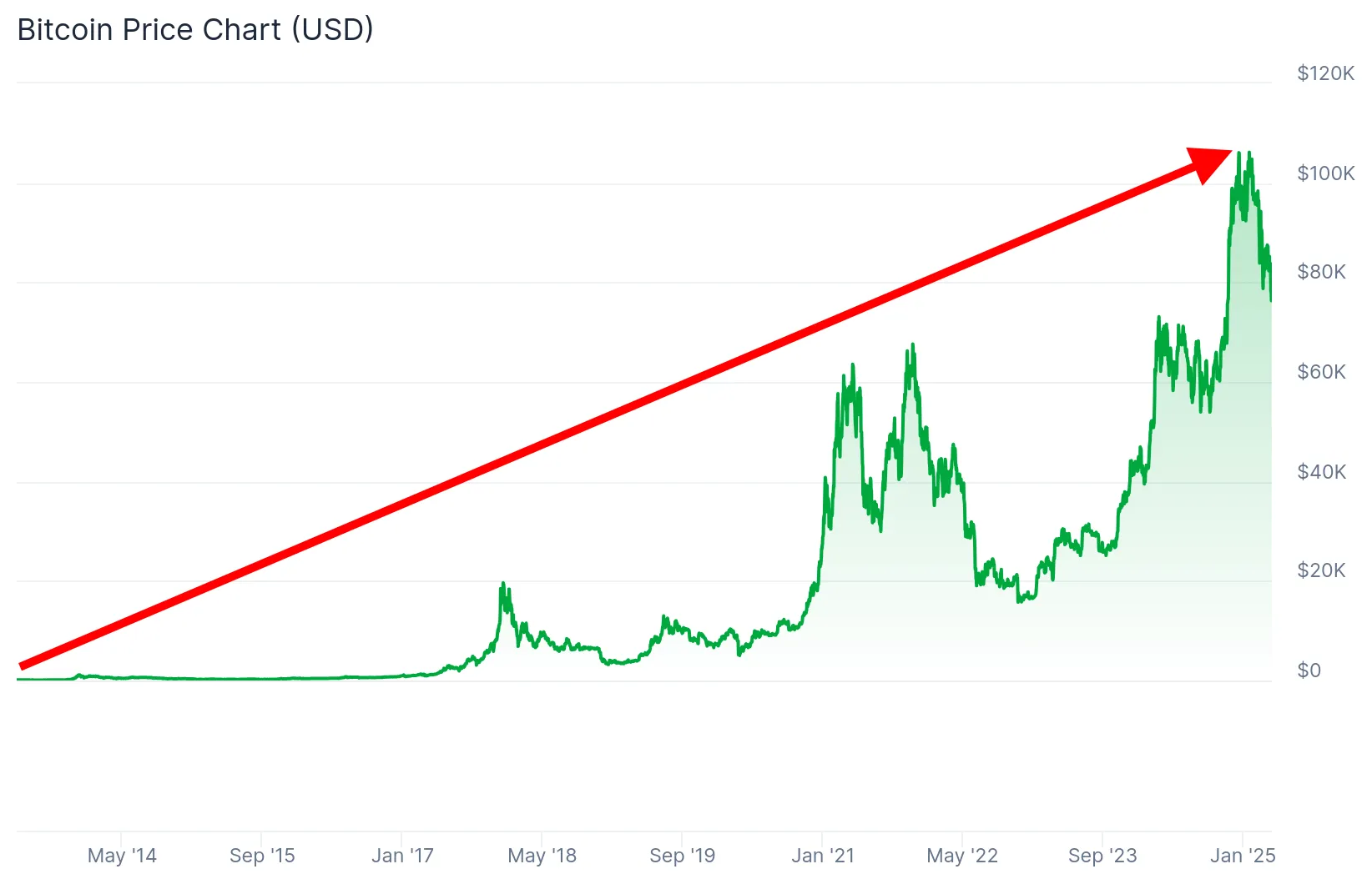

Cryptocurrency Exchange Rates 📈
Until now, we’ve discussed only the technical principles of cryptocurrency operations and mining. These principles determine how many coins you will earn through mining.
However, buying coffee with Bitcoin or Monero isn’t yet universally possible. Cryptocurrencies often need to be exchanged for fiat money like dollars, euros, and other currencies.
The exchange rate depends on the market capitalization of the cryptocurrency. Capitalization is influenced by factors such as the coin's popularity, investor interest, adoption rate, and numerous other factors.
Thus, profitability in dollars also depends on the exchange rate of the mined cryptocurrency.
For example, imagine a coin is priced at $10. You have two of these coins, which you can sell for $20. If the price doubles tomorrow, you will still have two coins, but now you can sell them for $40.

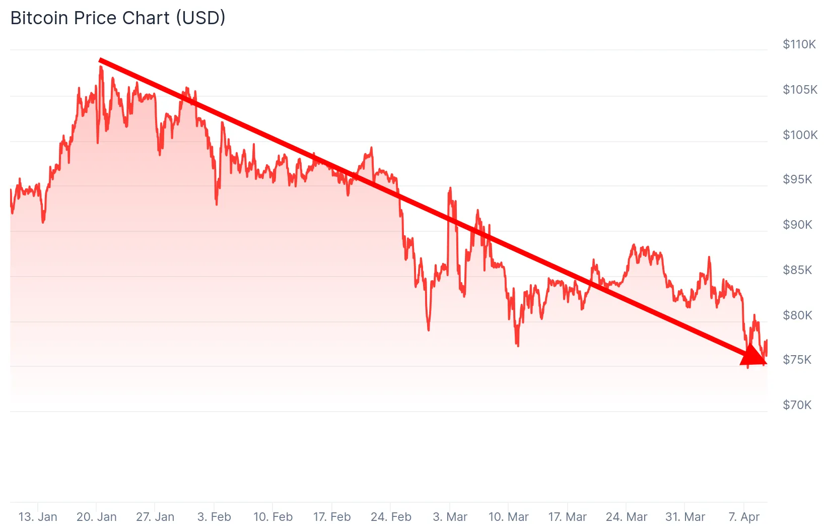

Cryptocurrency exchange rates are unpredictable and constantly fluctuate. A coin might lose value suddenly or unexpectedly become the most valuable cryptocurrency in the market. When you store your savings in cryptocurrency, their dollar value will continuously rise and fall based on the exchange rate.
Mining profitability in fiat currency is directly tied to the cryptocurrency’s exchange rate:
  • Bitcoin Price Increase: A rise in Bitcoin’s price boosts profitability. For instance, 0.01 BTC mined at a $30,000 exchange rate yields $300, while at an $80,000 exchange rate, it would yield $800.
  • Bitcoin Price Decline: A drop in price reduces profitability. If Bitcoin’s price falls to $20,000, the same 0.01 BTC would only yield $200.

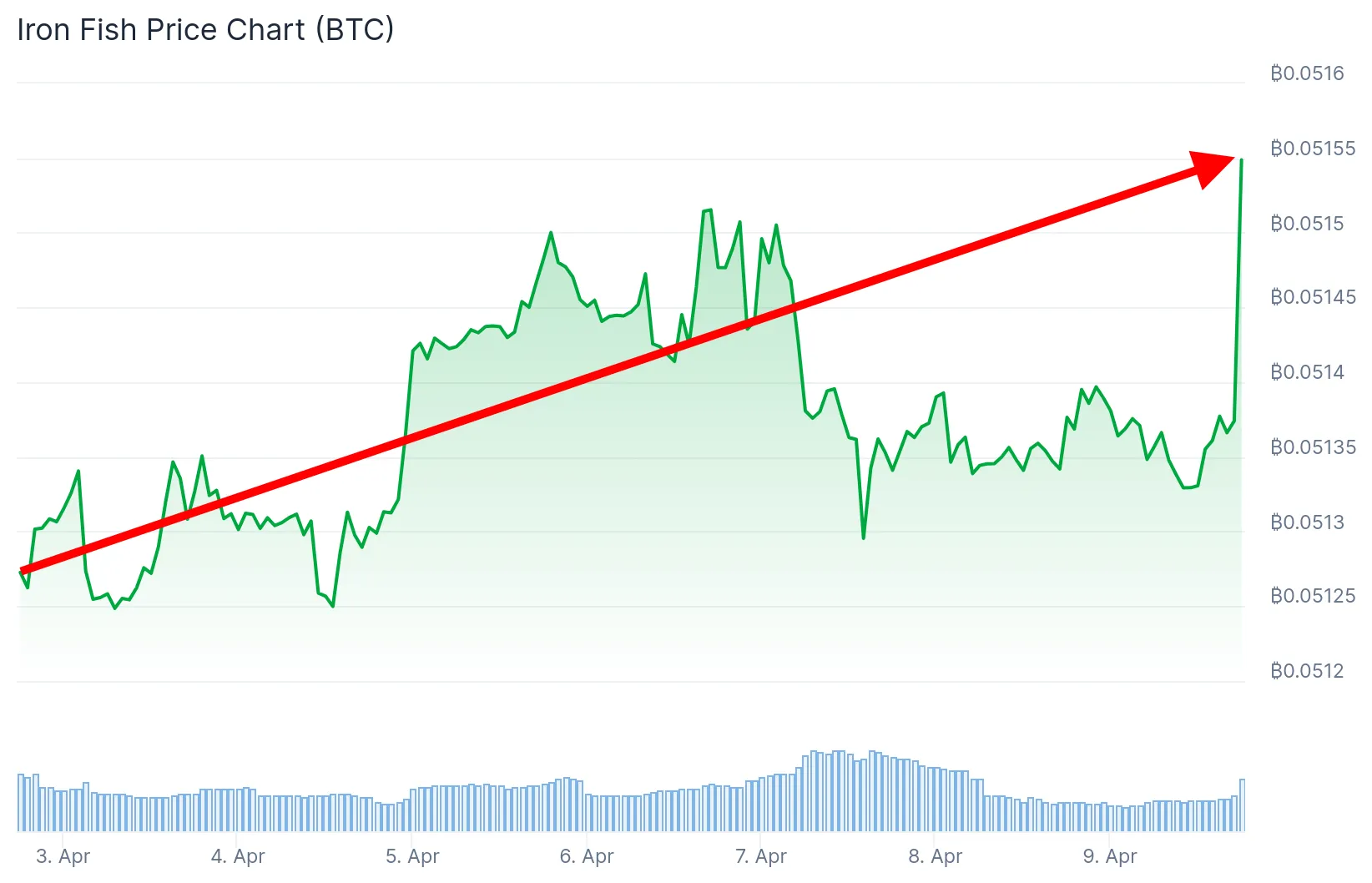

The situation for altcoins is similar:
  • Increase in Altcoin Price Relative to Bitcoin: If mined altcoins can be exchanged for more Bitcoin, your profits increase. For example, if the exchange rate rises from 0.0001 BTC to 0.00015 BTC per altcoin, your earnings grow.
