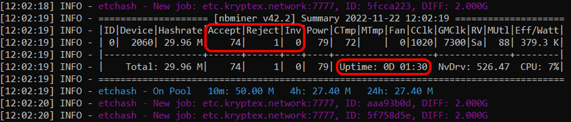

You can go to the Kryptex settings and check the "Show miner windows" checkbox. After that, it is worth waiting for a while for the miner to enter operating mode.
  • If there are too many rejected (invalid or stale) shares — the Kryptex application will notify you.
  • You can also track shares in real-time. Open Kryptex settings and tick the box "Show miner windows". After starting the mining, you will see the miner's window, where you can track the mining process.
During the usual mining process, the percentage of rejected shares should not exceed 1-2%. To get accurate data, you must mine for at least 1 hour (best for 24 hours). Therefore, the longer a continuous mining session lasts, the more accurate the data.

In its window, the miner shows the status for each found share. Shares may be labeled differently in different miners, but the meaning is the same:
  1. Share accepted — everything is fine, the pool has accepted a share and it will be paid.
  2. Invalid share — bad share. The GPU made a completely wrong calculation (2+2=5). Usually, such shares are eliminated at the checking stage by a computer and not sent to the pool. On a properly configured GPU, there should be no invalid shares.
  3. Rejected (Stale) share — share was sent to the pool, but the pool rejected it. Most often, this is a share that came to the pool too late, and someone else has already found the same one.
