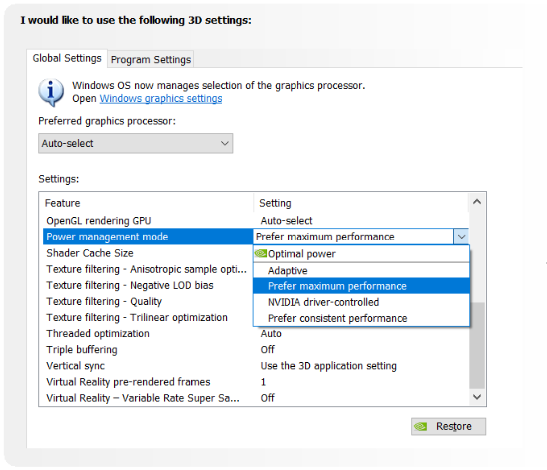

🔋The performance modes of Nvidia GPUs
Nvidia graphics cards have several power management modes. Under normal circumstances, the driver determines which mode to use and how much power the graphics card should consume for efficient work.
The selected power mode directly impacts the power consumption and performance of the graphics card during the mining.
Power Modes for Nvidia Graphics Cards
If the driver uses the mode wrong, it may cause a drop in hash rate due to reduced power consumption.
🚀Select the correct mode yourself!
If your Nvidia graphics card only shows a fraction of your desired hash rate — enable "Maximum performance" mode in the Nvidia panel!

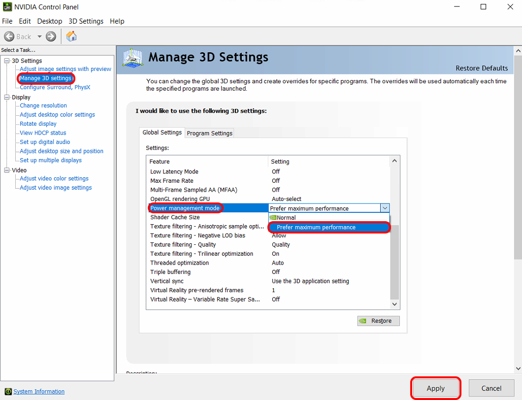

  1. Right-click on your desktop;
  2. Select "NVIDIA Control Panel" from the context menu;
  3. In the opened window, on the left side of the column, select "Manage 3D Settings";
  4. Scroll down through the settings list, and select the "Power management mode";
  5. Select the "Prefer maximum performance" option;
  6. Apply the settings and reboot the PC.
Choose option: Prefer maximum performance
Done! Your GPU will work at its best and bring you maximum profit with Kryptex!
