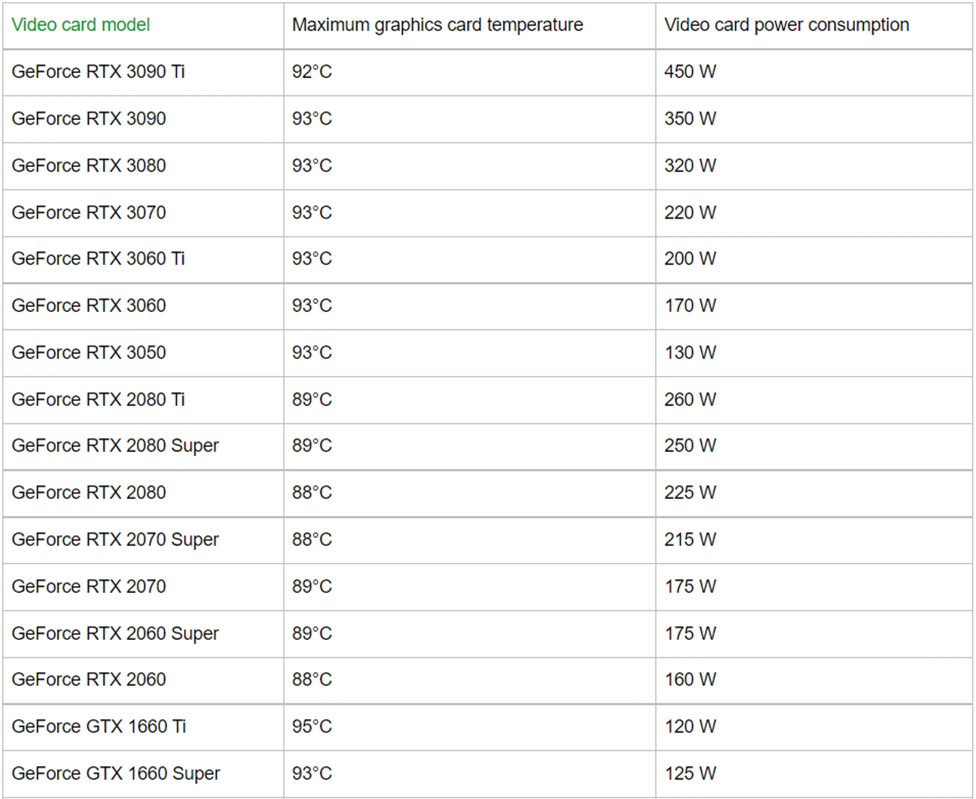

🧐 What does the graphics card's temperature depend on?
The temperature depends on the efficiency of the cooling system and the heat dissipation of the chip. The more powerful the card, the more heat it generates.
For Nvidia RTX 2060 and RTX 3060 Ti cards, the temperature limit is 93 degrees. Because of this, you need to compare 2 different GPUs not only by the type of cooling, but also by the power supply of the chip.
Often, people forget about the power subsystem and the memory chip. They need stable air flow at 50% of the fan power so that the stability of the work is not disturbed.
😥 What temperature should I be afraid of?
Critical — temperature that must not be exceeded, otherwise breakdowns may happen. Each video card has its own limitations.
For some, at high temperatures, the memory chip fails. For others, the graphics chip fails or the capacitors overheat.
For all cards from Nvidia, the allowable temperature is 93 degrees. For AMD, the optimal temperature is considered 90-100 degrees.
Ideally, it is desirable to have 5-10 degrees in reserve. For the video card to work normally and not overheat.

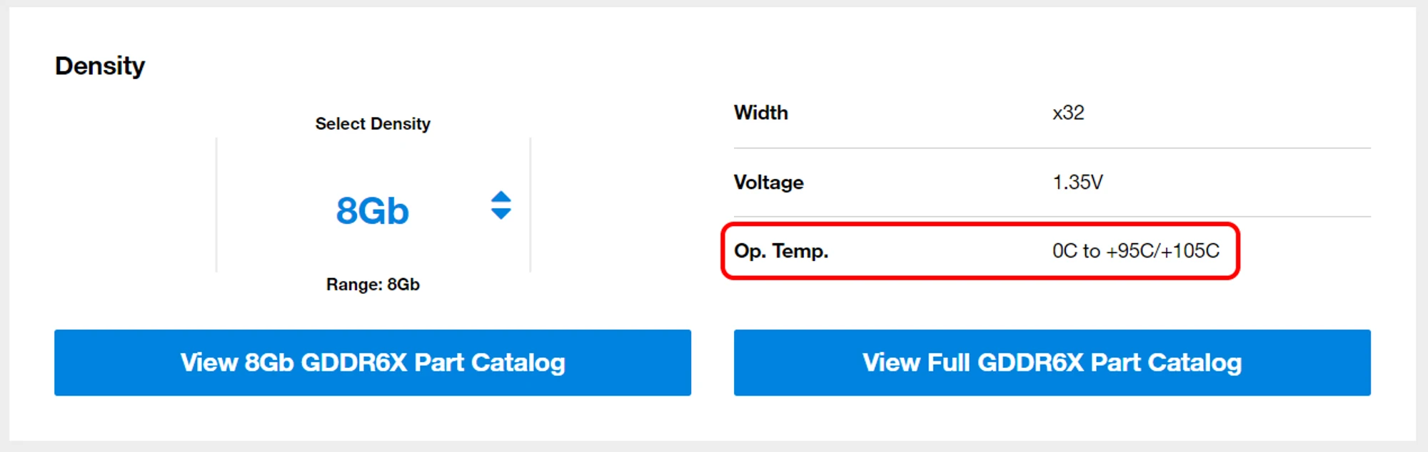

Memory generates a lot of heat. It does not have enough minimum airflow so that it does not overheat. Always keep an eye on the temperature of the memory chips. It is advisable not to warm them up more than 100 degrees.
If the memory chips get very hot, this is a sign that it's time to change the thermal pads and increase the fan speed.
Micron claims that their GDDR6X memory can operate above 100 degrees.
