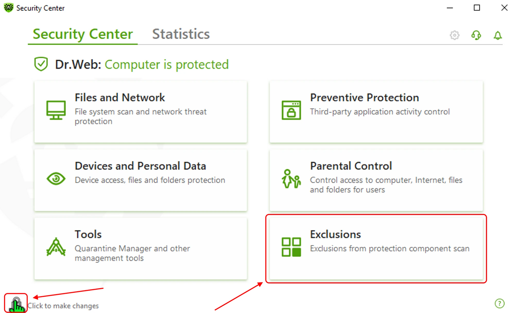

  1. Open the Dr.Web menu and select “Security Center”. Make sure Dr.Web is running in administrator mode (the lock at the bottom of the program is open). Otherwise, click on the lock to unlock it.
  2. Click on the "Exclusions" button.

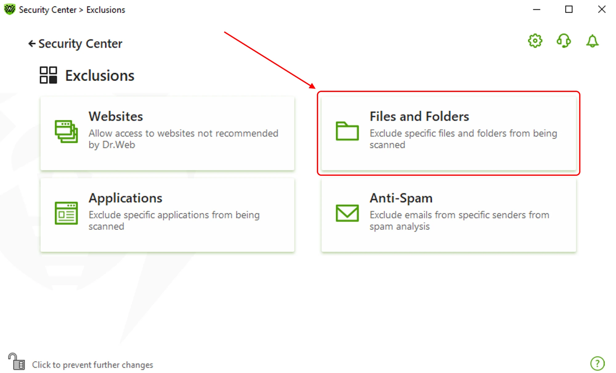

  3. Click on the "Files and Folders" button.
  4. Next, specify the files and folders that you want to exclude from the antivirus scan:
    • C:\Program Files\Kryptex
    • %AppData%\Kryptex
    • %AppData%\Kryptex\miners
  5. Click "OK" and then "OK" again to apply and save the exclusions.
