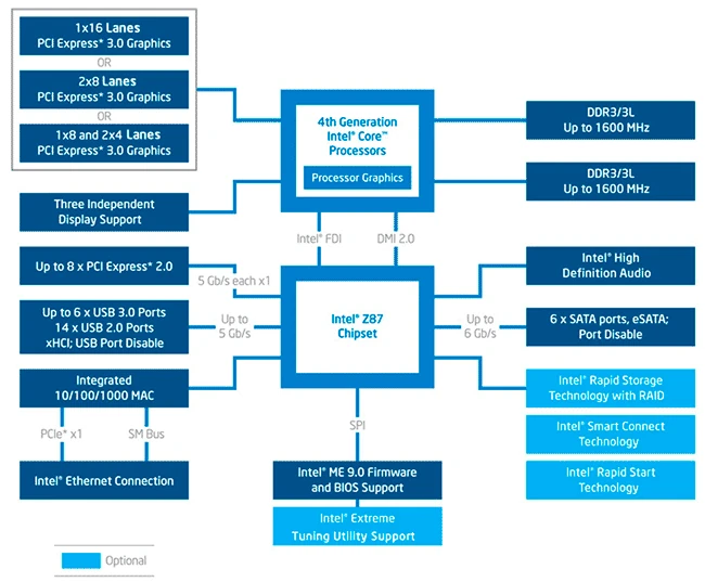

Intel decides that only the processor is responsible for the amount of PCI-E graphics lanes.
Chipset Intel Z87

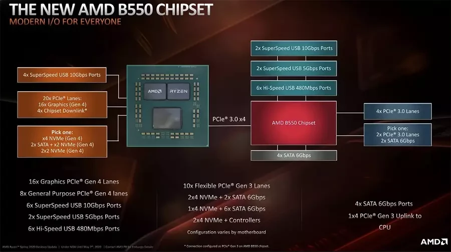

While AMD processors share PCI-E lanes with the motherboard.
AMD B550 chipset

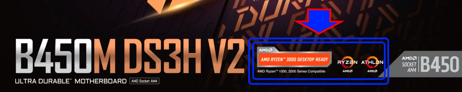

Some CPUs and motherboards are compatible “from the box,” as evidenced by the inscription on the product itself.
The compatibility description on the motherboard box
Sometimes you may need to install a newer version of the motherboard BIOS to support the processor. Or it can happen that the processor and motherboard are not compatible at all, even though they have the same connector type.

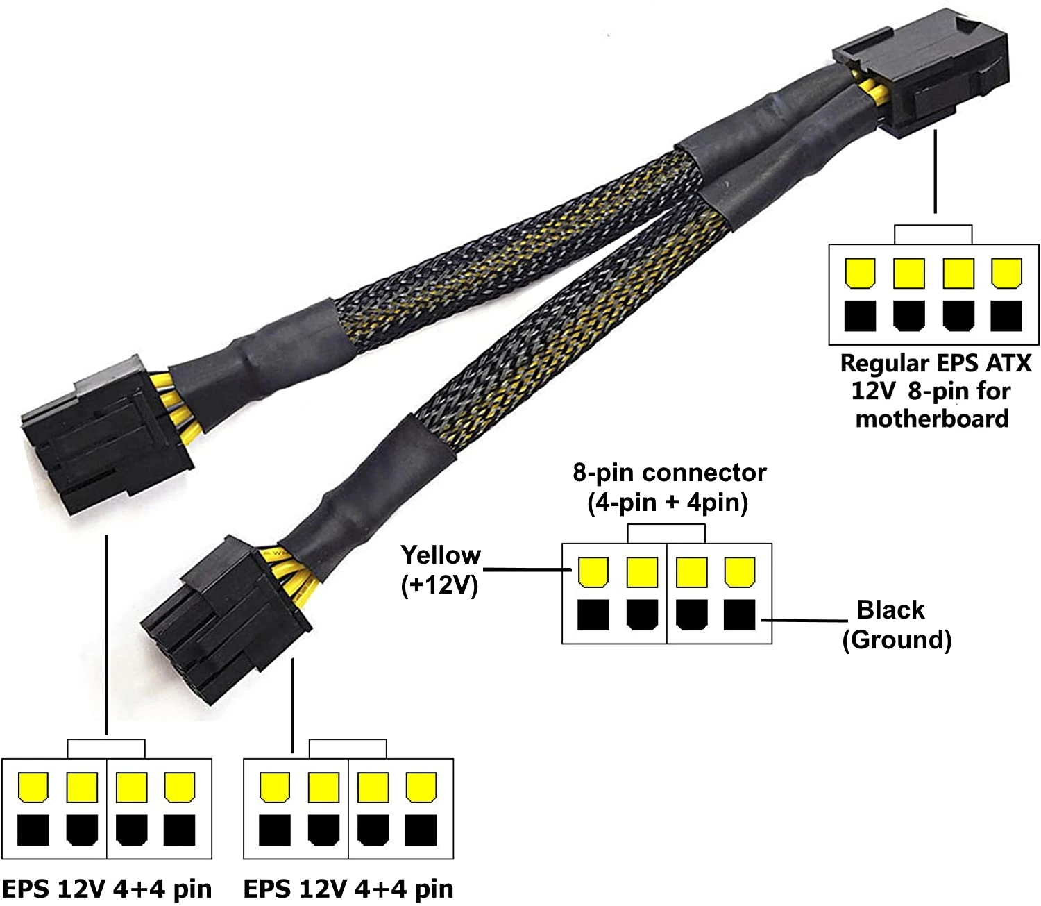

The processor is powered by the ATX lane, represented as a square connector with four pins. The more power the processor consumes, the more connectors it needs to power it.
CPU power can be represented as a single four-pin connector, a dual 4+4 pin connector, or an entire eight-pin connector.
The more powerful the power supply is, the more processor's pins it will have.
Not to be confused with graphics card connections, these are different connections!
CPU power connector
CPU power connector
