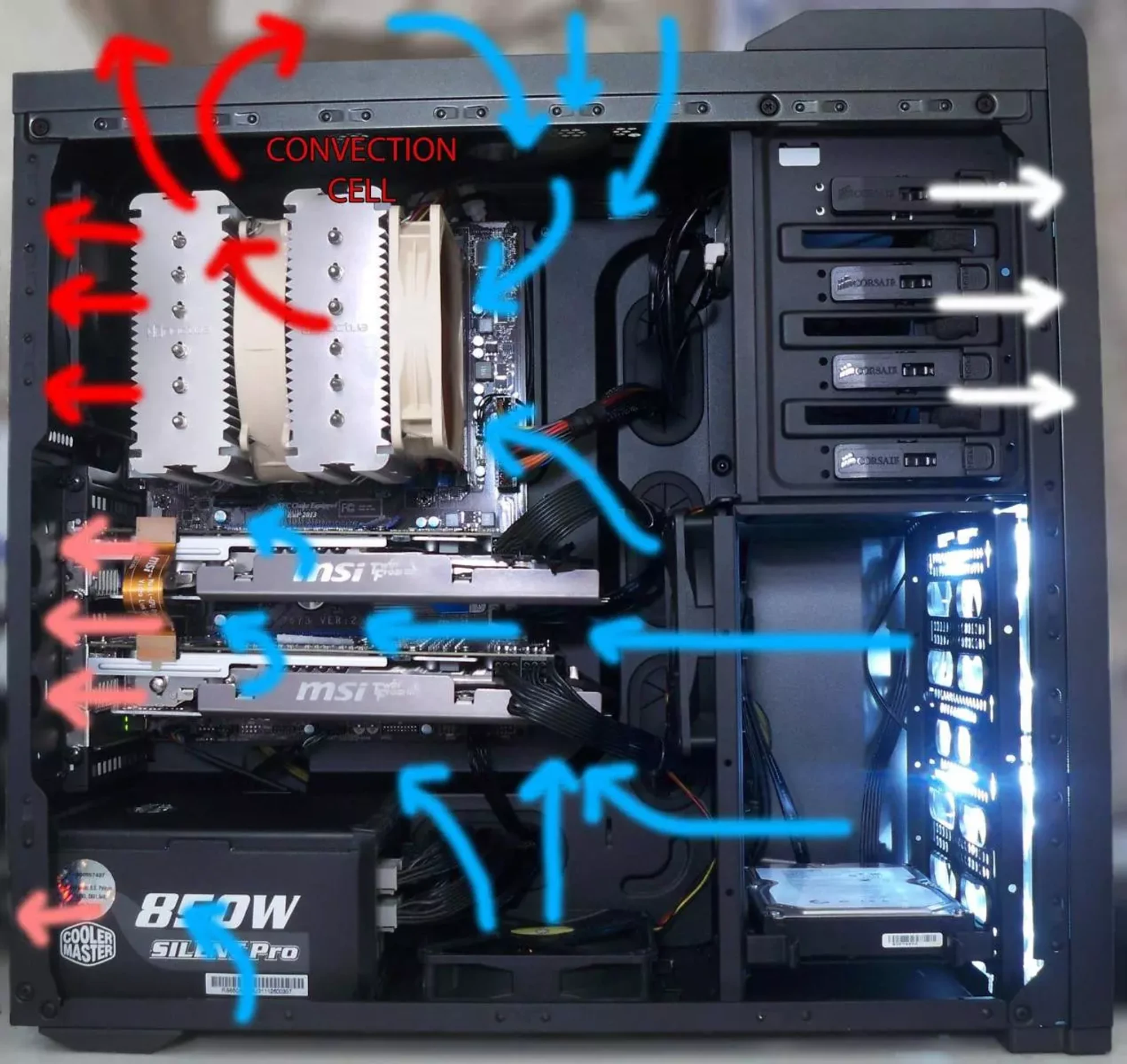

The figure shows the natural movement of cold and heated air in the system unit.
As you can see, such a system creates a reasonably powerful draft inside the PC case: cold air flows around the graphics card, creates turbulence near the processor, and exits through the back and top of the case, removing excess heat outside the case.
