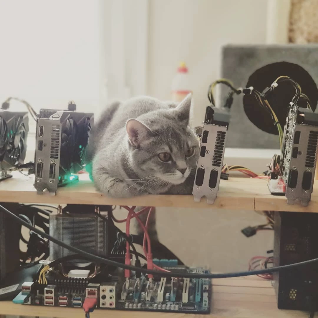

Riser acts as an extension cable allowing to put GPUs outside of the case. You can even construct a unique chassis for your cards. But be aware — your cat may find a new comfortable spot to spend its free time 🐱 Kitty and a farm

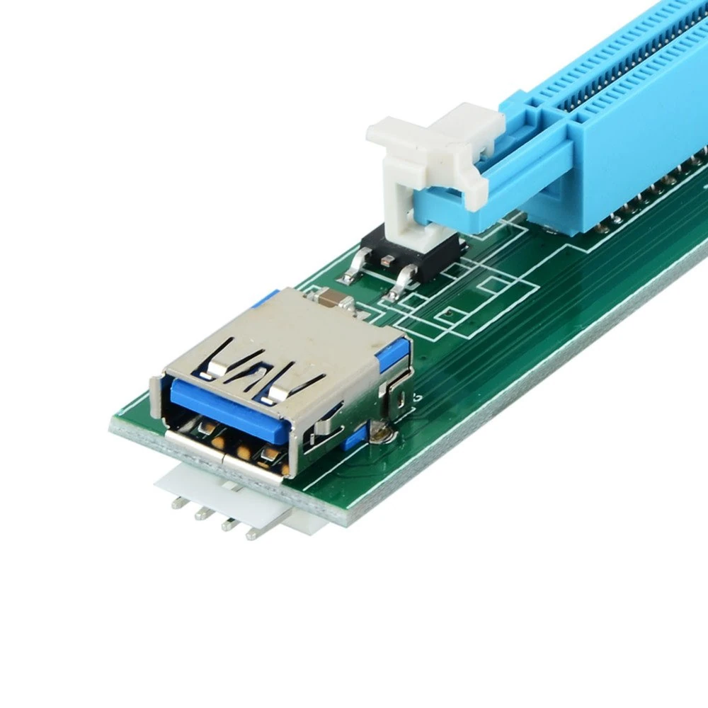

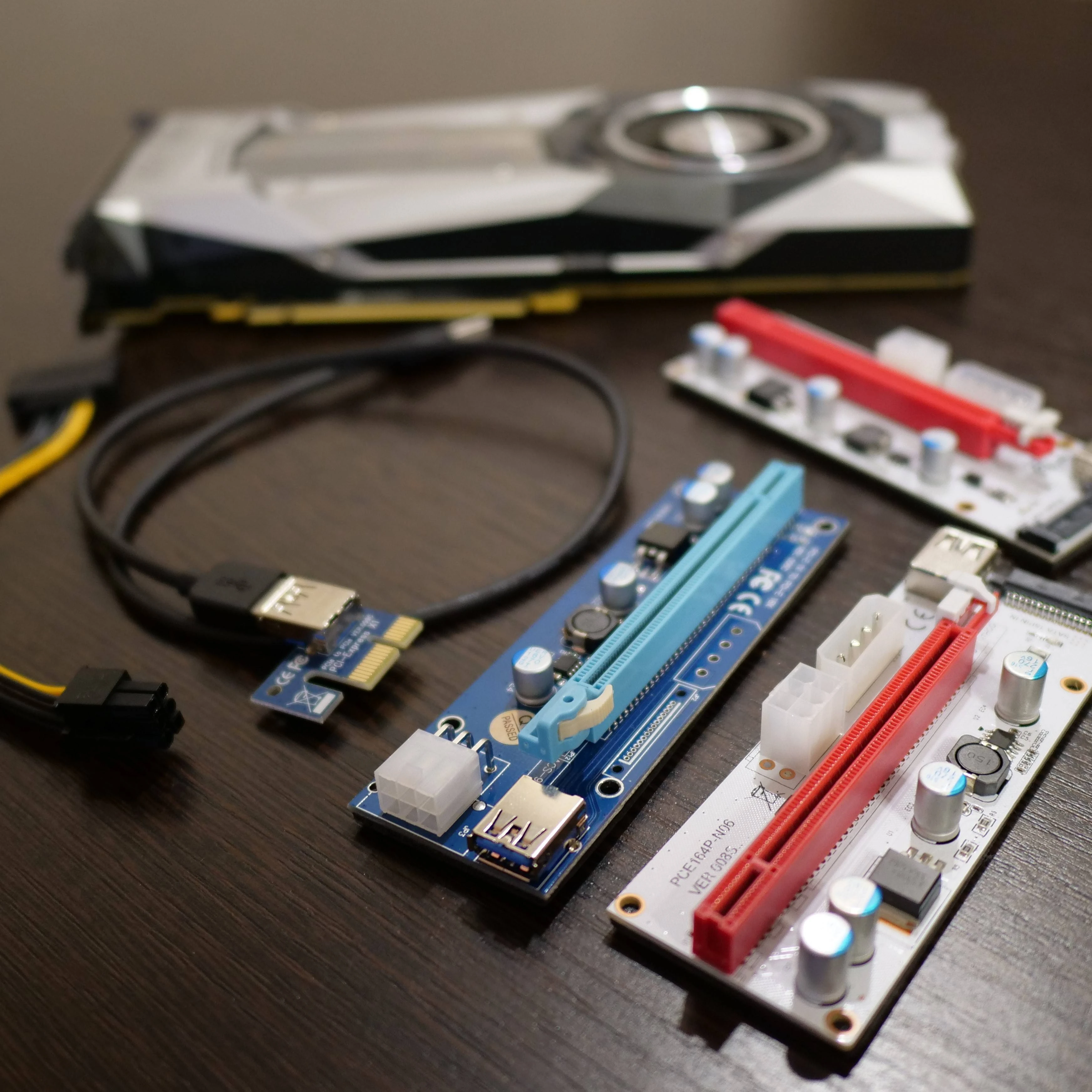

A riser is used to relocate PCIe slot acting like an extension cord. One side is connected to the motherboard, the other end to the GPU. That's it! Typical risers with USB connections and an additional power source
Usually, riser comprises three parts:
  1. A small board with a PCIe x1 plug, which goes into a motherboard;
  2. Another board with a PCIe x16 socket to insert a GPU in;
  3. A USB cable to connect those two boards.
Sometimes additional power connectors are bundled with the core package.

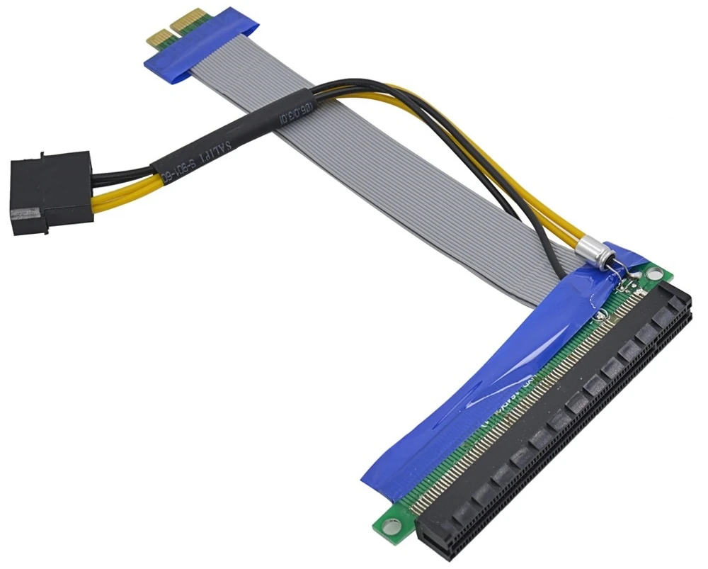

Flexible x1-x16 risers
Flexible connector riser. Don't buy those!
Do not buy any kind of these. Rubber cable sleeve does not protect the cable itself from any of electromagnetic interference. Thus, any defect may affect mining. These risers also lack extra power delivery options bringing an extra load to a PCIe slot.

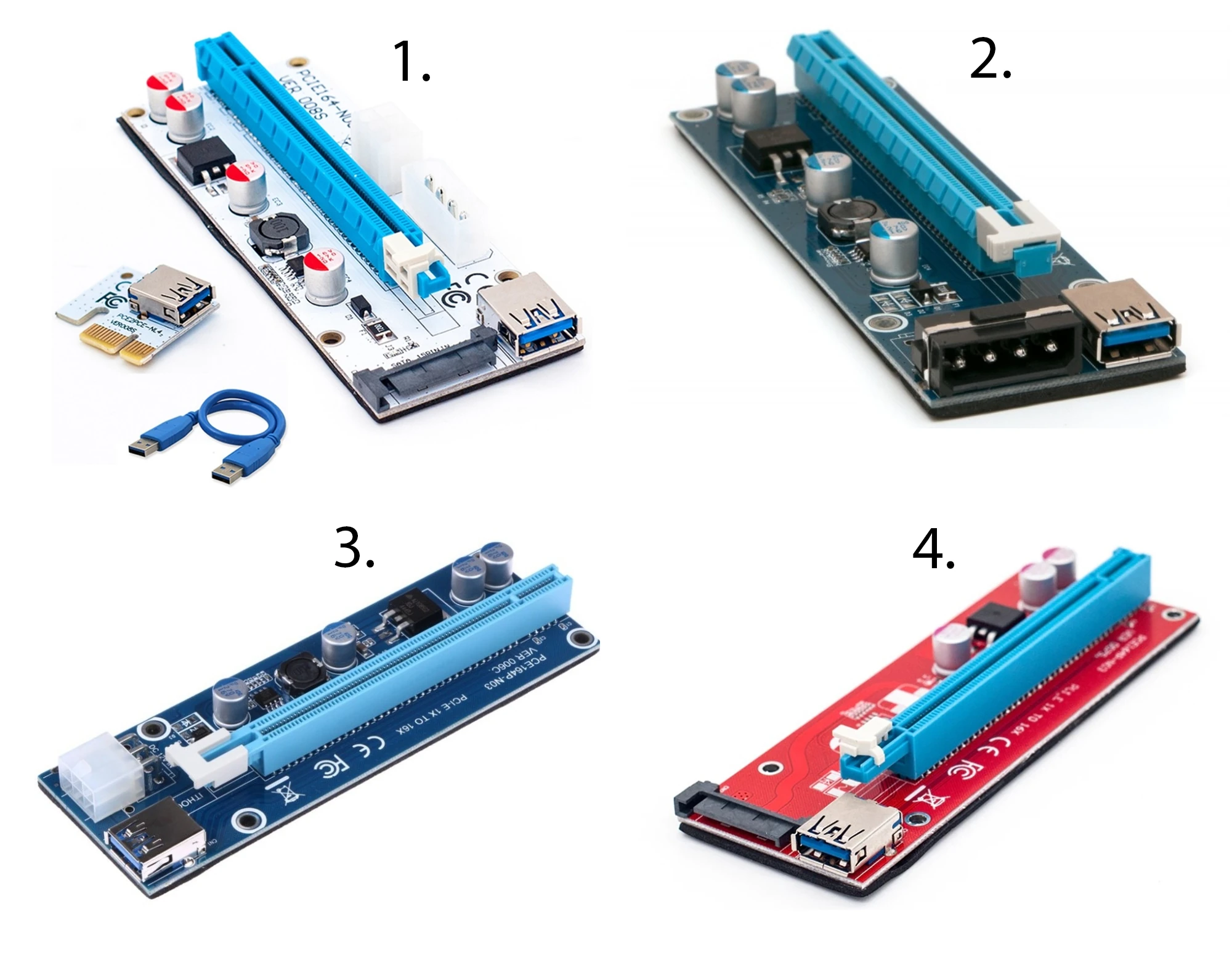

All risers, except those stated above, are safe to use. They mostly differ with power input type. Best to worst:
  1. Universal has multiple connection options on a single board — use any.
  2. 4pin Molex;
  3. 4-8pin PSU;
  4. 15pin SATA.
⚠ SATA power risers notice ⚠
15pin SATA is generally used to power low consuming HDD, SSD, ROM, etc. Thus, PSU manufacturers tend to cut costs on SATA cables, making them thinner less durable. If cable thickness or connector quality raise your concerns, use a different riser type.

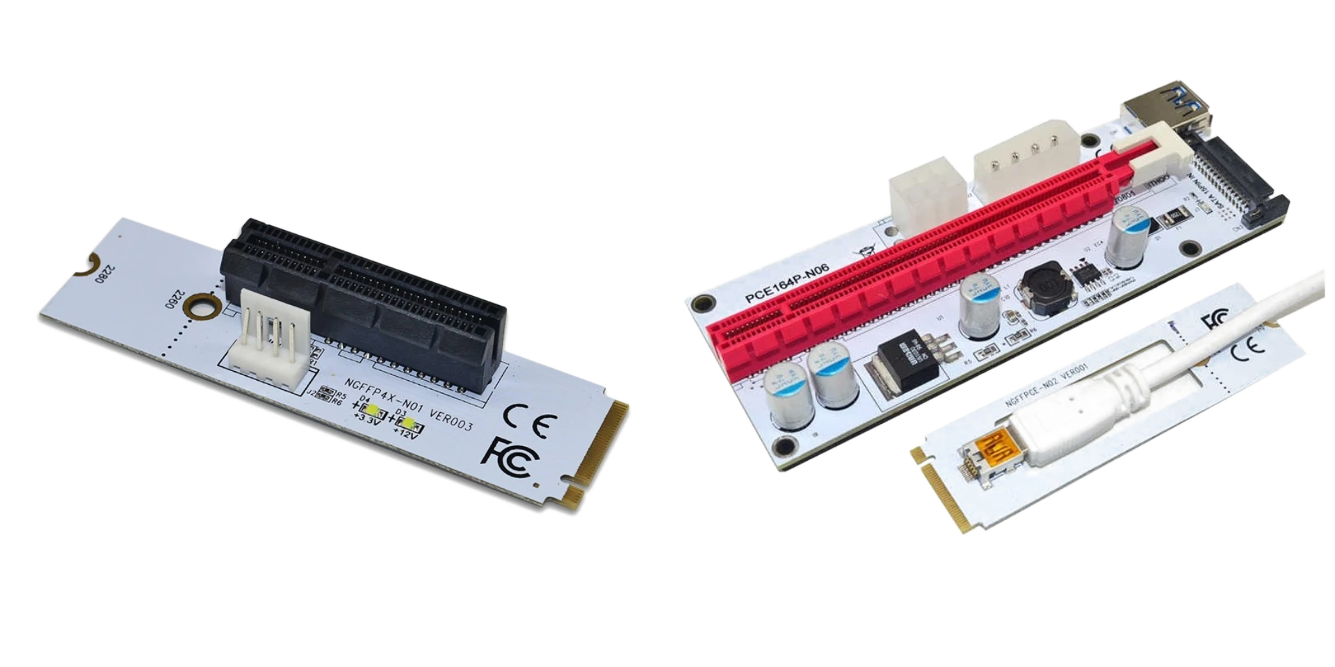

M.2
M.2 is a specification for internal expansion cards, mostly SSD. Internally, it can be connected to the SATA or PCIe lanes. If your's is utilizing PCIe, try an M.2 riser. They come in the form of direct adapters, in which you connect your typical riser, as well as in the form of a usual USB extender.
Only PCIe M.2 slots can run risers. SATA connection will not work!

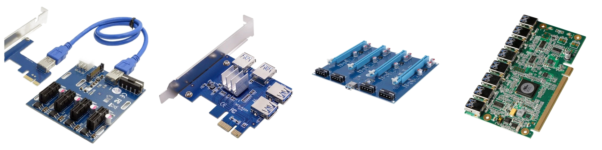

Splitters
If your motherboard runs out of PCIe slots, but you still need to add extra cards, you may think about buying a splitter instead of a new motherboard. Sound like a great way to save a buck, right? Wrong. More often than not, splitters do not work as intended. They tend to glitch, losing connections with cards, and not being able to endure overclock.
Here at Kryptex, we prefer spending extra time with our friends and family instead of figuring out what GPU once again went offline because of the splitter. 😒
