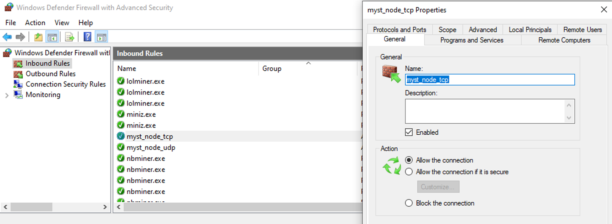

  • Make sure that permissions for myst_node are created in the firewall. Run the CMD command line and execute the wf.msc command. Select the "Inbound Connection Rules" item. Find myst_node_tcp and myst_node_udp in the list. Make sure they are allowed all connections.
