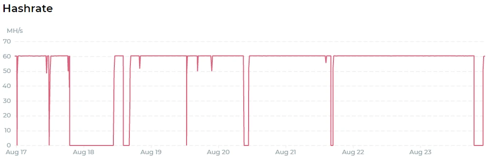

Finding out that there are technical problems is quite simple. They usually give you a very ragged hashrate graph. Go to your personal account in the "computers" tab. Click on the computer name and select the “Hashrate” tab.
The hashrate graph on this tab should be flat, without any major dips. If it looks like the picture below, you should look for the reasons.
"Bad" hashrate graph
You may also be alarmed by the uneven Earnings history in the Dashboard.

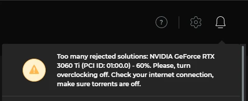

Large number of rejected solutions
If the pool rejects part of your solutions, you do not receive part of the profit! Read more about this on the page Large number of rejected solutions.
Usually Kryptex app shows you a notification about this. Check if you have had such messages.
Too many rejected solutions message
