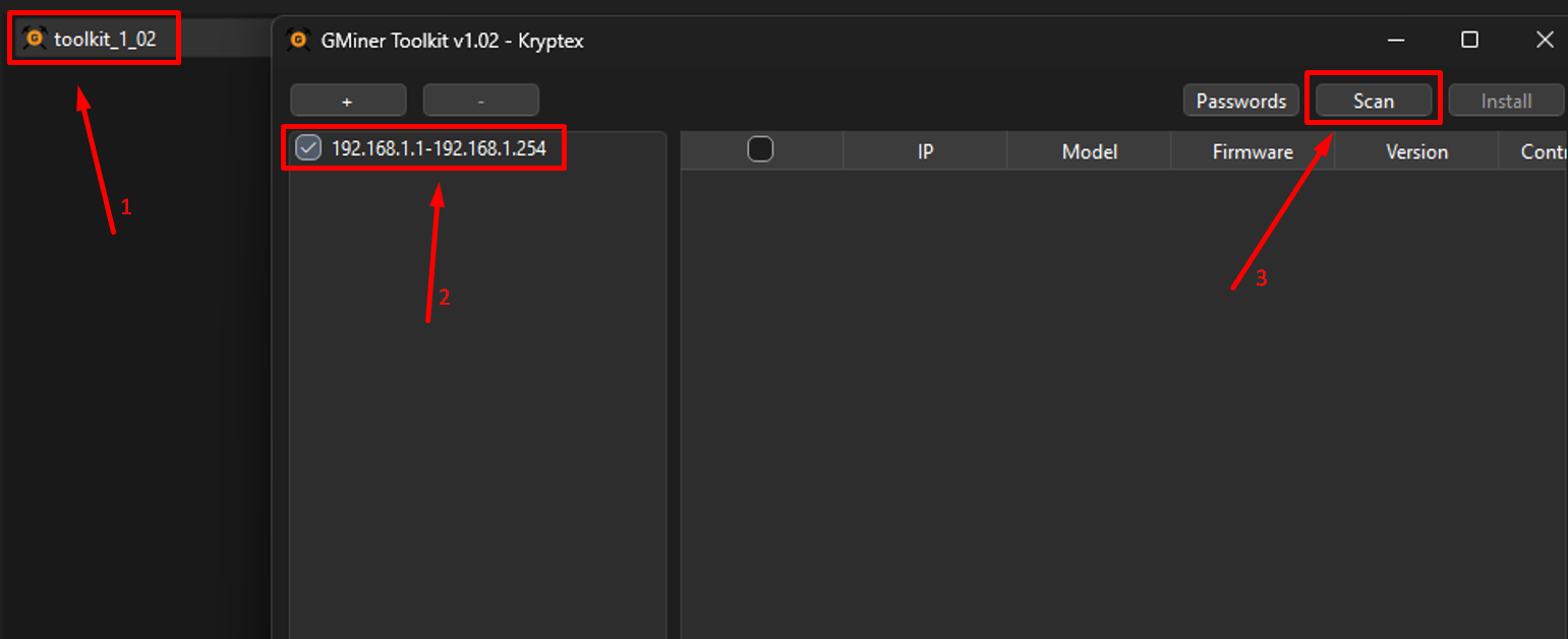

Important! to install Kryptex x GMiner firmware use Toolkit, ASIC firmware should be before march 2024
2
Open the Toolkit → click “New Group” → enter a group name and the local IP address range → click “OK”, then “Scan Local Network”

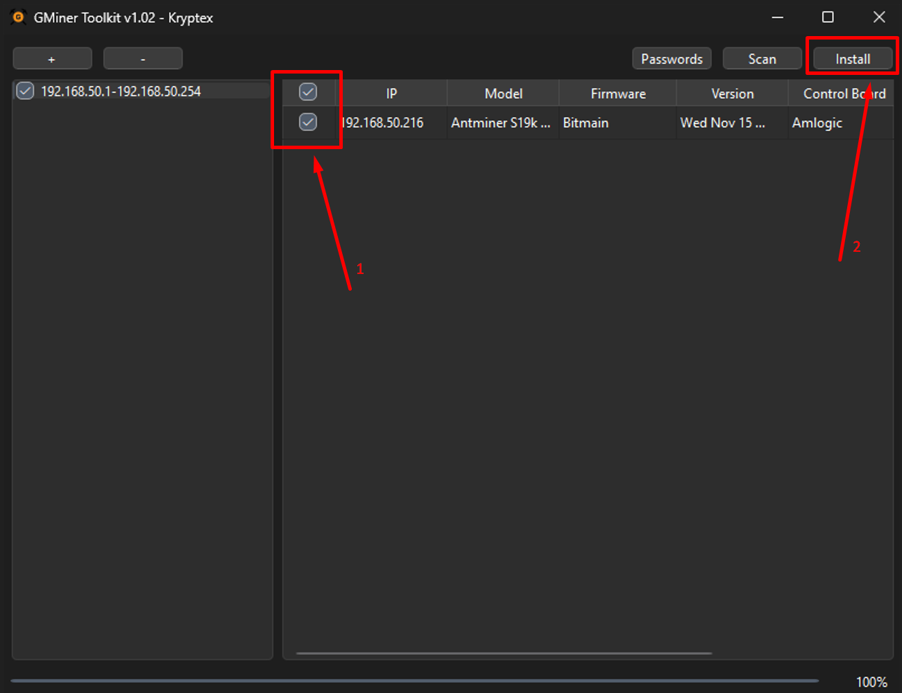

3
Select the new group, choose the ASIC from the list, and click “Install Firmware”
Installation step 3

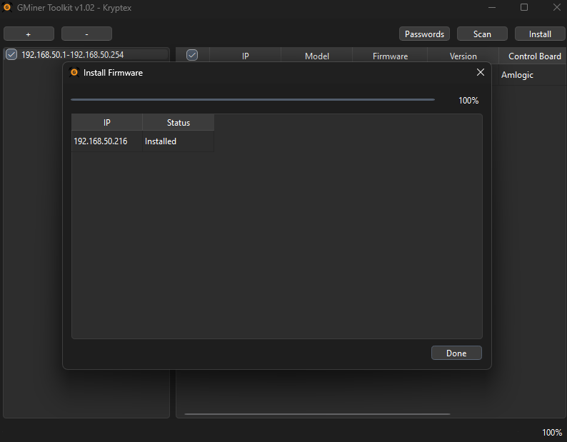

4
Wait for the installation to complete, then click “Done”
Installation step 4
That’s it – the new firmware is flashed and your miner will reboot automatically.
