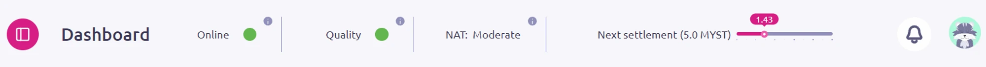

You can understand whether everything is in order using three metrics: Status, Quality and NAT.
  1. Status — Indicates the status of your node and its monitoring by Mysterium.
    • 🟢 Green (Online) — Your node is online, the test was successful, everything is functioning well, and monitoring is operational.
    • 🟠 Orange (Pending) — Your node is awaiting a test or the test is in progress. Verification does not happen instantly and may take from 1 hour to 24 hours. If your internet speed is below 20 Mbps, the test might require several days of continuous operation.
    • 🔴 Red (Offline, Monitoring Failed) — Your node is offline, or the verification failed. Keep the node turned on for at least 24 hours, or 72 hours if your internet speed is below 20 Mbps. You can expedite the check or initiate it again through the following methods:
      • Additional Check: Click on the gear icon next to Mysterium in the Kryptex window. The Web UI of the node will open. Navigate to the “Settings” → “Mystnodes.com” → “Integrations”. Register on mystnodes.com and link your node to your personal account. Select a node in your personal account → menu with three dots → “Test node””Check connection”. This enables you to run an extra check every 10 minutes, but the node status is updated no more than once per hour.
      • Contact Mysterium Support: In the Web UI of the node, click on the “Chat” tab. Ensure your node has been running continuously for at least 24 hours so that Mysterium support has sufficient data to assess your node.
  2. Quality — Indicates the quality of your connection. To generate income, the quality must be green or at least orange.
    • 🟢 Green: means that your node service quality is high and any type of consumer can use your node for their needs.
      • May shift to orange if the connection drops frequently.
    • 🟠 Orange: means that your node service quality is good. If the consumer requirements are not incredibly strict, pretty much any type of consumer can use your node.
      • Orange may transition to green after a few days of continuous node operation.
    • 🔴 Red: means that your node service quality is poor.
      • Your node has not yet been verified. Once the test is successful, the Quality will change to green or orange.
      • If the check passes, the Status is green, but the Quality remains red, it indicates low node quality. Consumers are unlikely to use your node. You can initiate the verification process again or contact Mysterium support for clarification.
  3. NAT (an abbreviation for Network Address Translation) - Indicates the complexity of routing your connection.
    • Open: this status indicates that the node is capable of establishing connections with any type of consumer. Your connection is unrestricted, and you have a dedicated static IP address.
    • Moderate: this status indicates that the node is capable of establishing connections with most types of consumers. This is the most common NAT type.
    • Strict: this status indicates the node can only establish connections with Open NAT type consumers. Your connection is more strictly controlled by your ISP, network administrator, or your router settings. You can attempt to improve the state to Moderate through port forwarding.

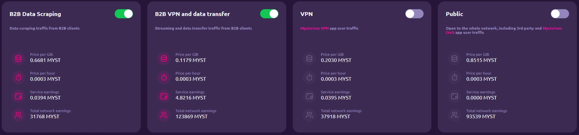

  • Adjust Mysterium Network Options: Control your income by turning on or off additional Mysterium Network options on your node:
    • Access the web interface of the Mysterium node.
    • Navigate to the Dashboard, switch on or switch off additional options.
    • The more options you enable, the higher your potential income.
    • *For enhanced traffic security on your PC, consider enabling only the first two options: B2B Data ScrapingFor enhanced traffic security on your PC, consider enabling only the first two options: B2B Data Scraping and B2B VPN and Data Transfer.
