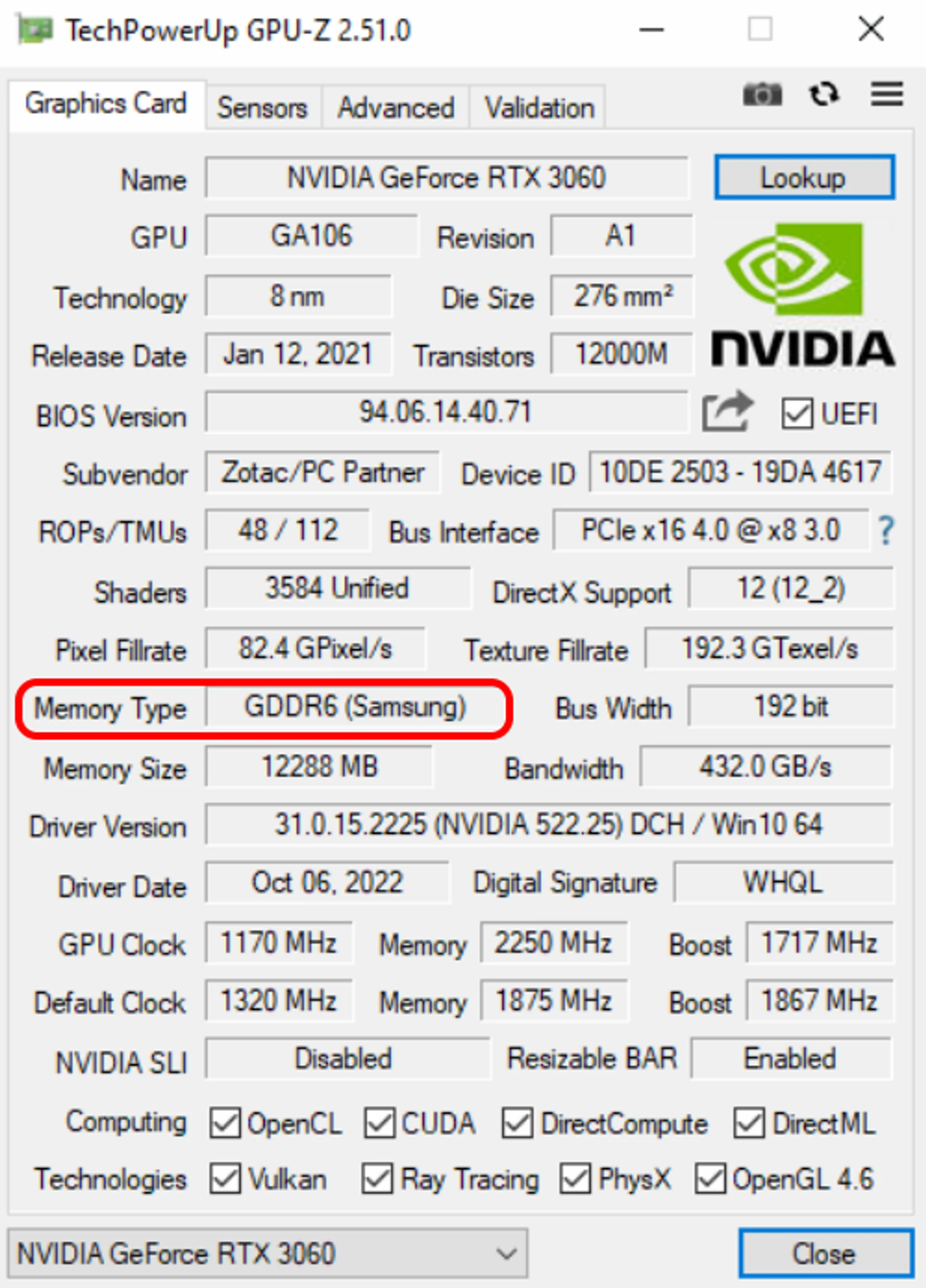

1. Find out the GPU's memory vendor:
Use GPU-Z app to determine the memory type and vendor of your GPU.
Take a look at the memory manufacturer in GPU-Z
Statistically speaking:
  • Samsung may clock as high as +700 MHz;
  • Microns are capable of around +500 MHz;
  • Hynix are the less flexible and stick only with an extra 200-400 MHz.
But there is an exception, such as the Nvidia GTX 1660 Super graphics card. If you come across Hynix memory on a video card of this model, lower the memory frequency to -502. It happened that on GDDR6 memory chips, Hynix memory has better timings at low frequencies.
The real boost is highly dependent on a single chip. Carefully increase your clock speeds to find out the value optimal for your particular setup.

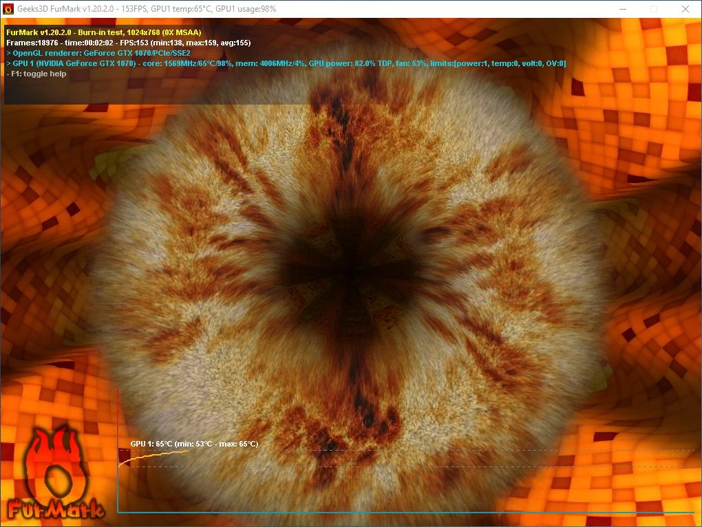

2. Live-track GPU's stability:
Launch FurMark stress-testing. This app will generate a load that will test the ability of your GPU to endure an overclock.
Run FurMark to check overclock stability

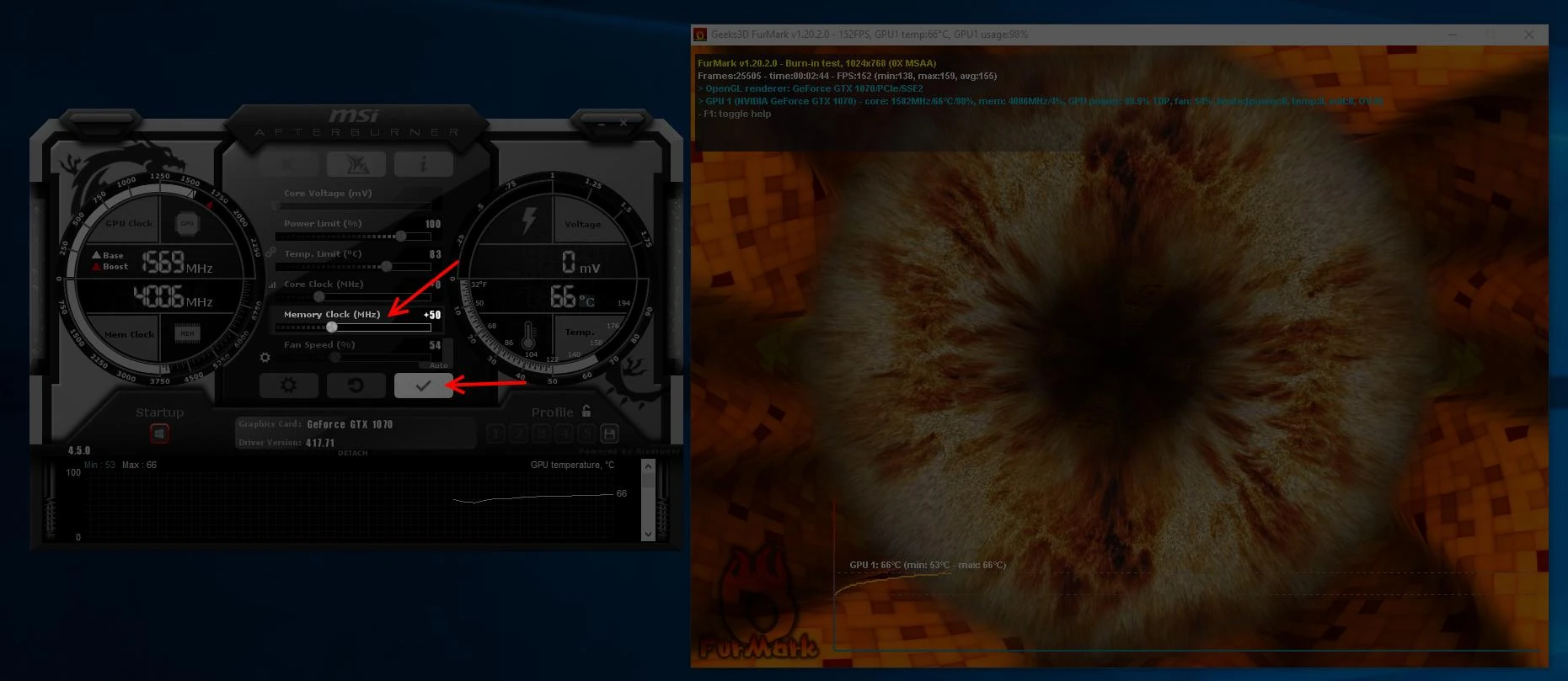

3. Boost the memory clock:
Use MSI Afterburner to overclock your video card. It has a user-friendly interface and works with any Nvidia or AMD GPU.
Overclocking memory using MSI Afterburner
Overclocking should be used with mining disabled!
  1. Launch the MSI Afterburner;
  2. Locate the memory clock slider and start to increase the value progressively. Stick with 50 MHz steps.
  3. Apply the settings and keep monitoring;
  4. Repeat these steps several times. Monitor GPU load and temperature after every adjustment.
At some point, your system will go unstable, and you will experience one of the following symptoms:
  • Visual artifacts (random flickers or stripes on the screen);
  • Furmark crash;
  • "Display driver stopped responding and has recovered" message;
  • Screen blackout;
  • BSOD.
Afterburner does not apply any changes at Windows startup by default. Thus, any destructive changes will be rolled back after the reboot for your safety.
Once recovered, set the memory clock to the last stable value you've noted.
For example, the system crashed at +650 MHz, then stick with +600 MHz boost.
