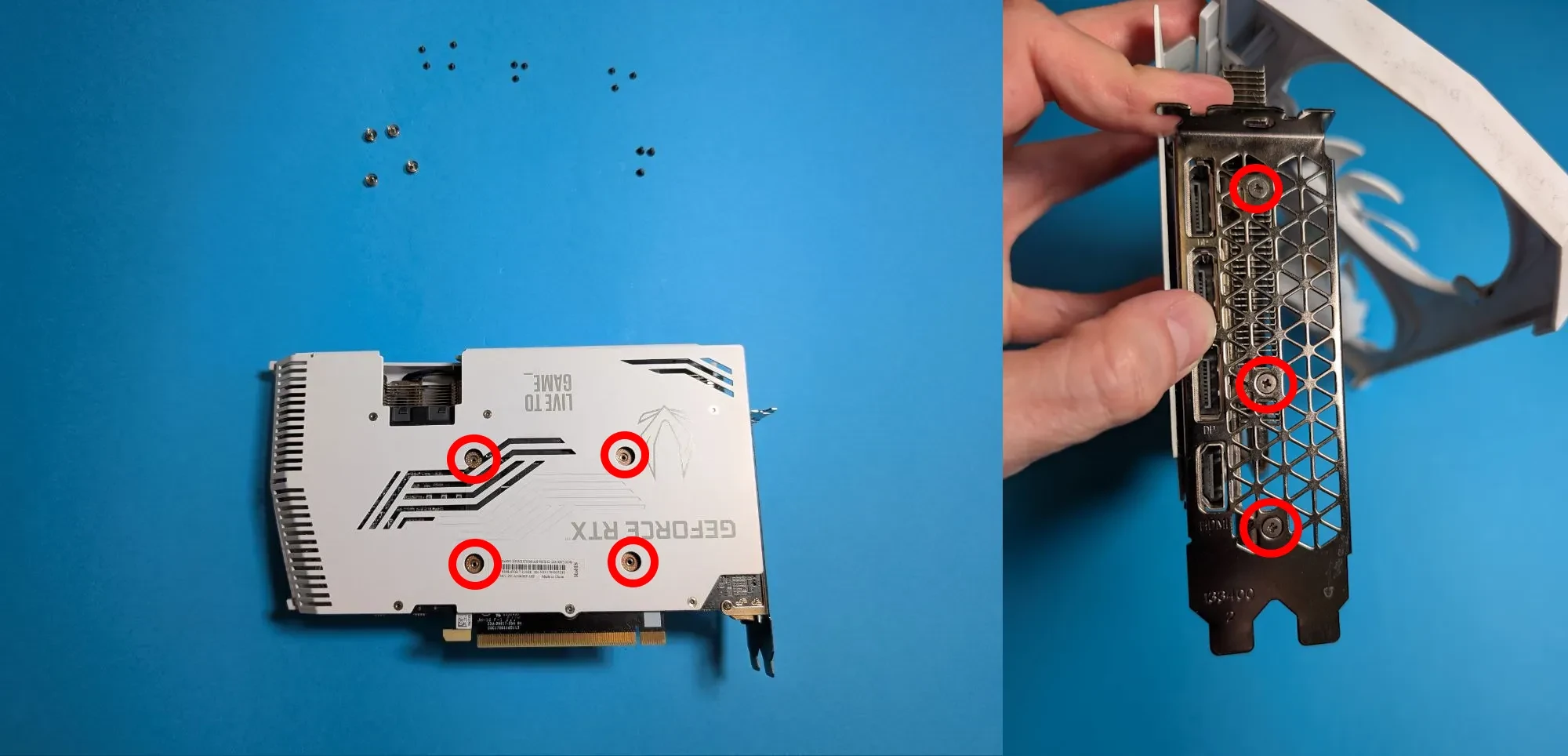

Removing the Plastic Shroud

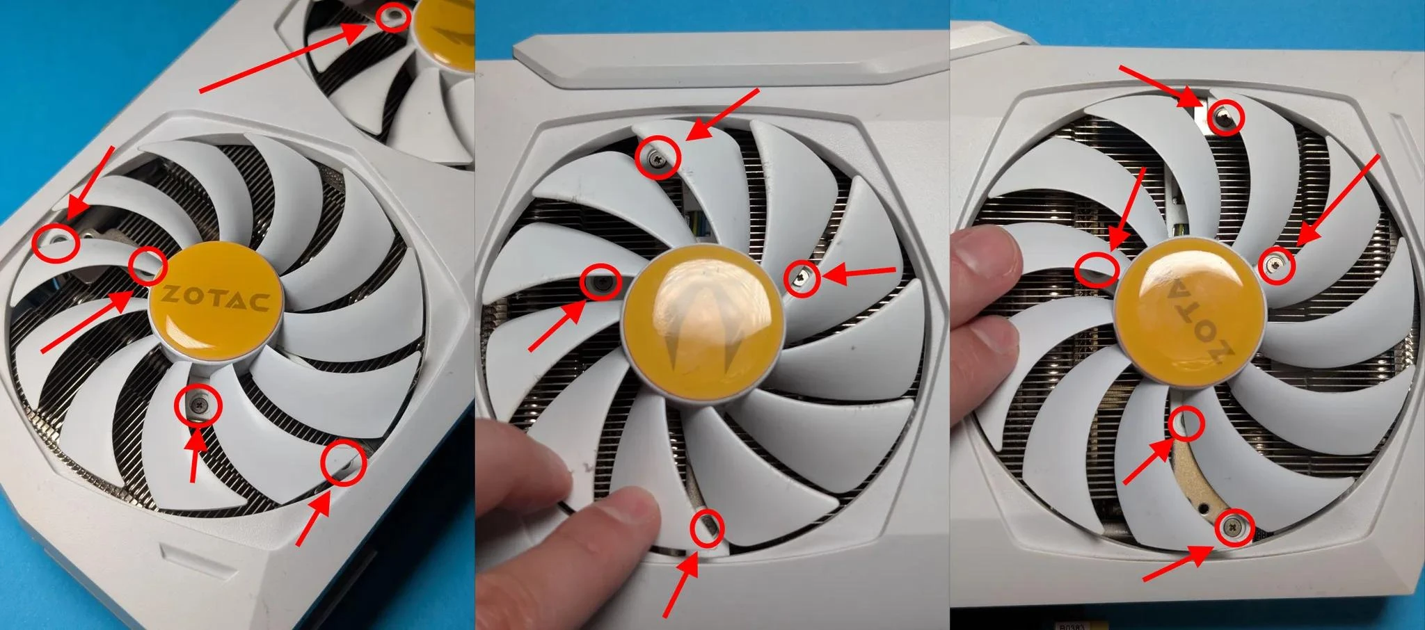

The shroud is usually secured with multiple screws, which may be located on the back, sides, or under the fans, depending on the GPU model.
  1. Unscrew all bolts, keeping track of their placement.

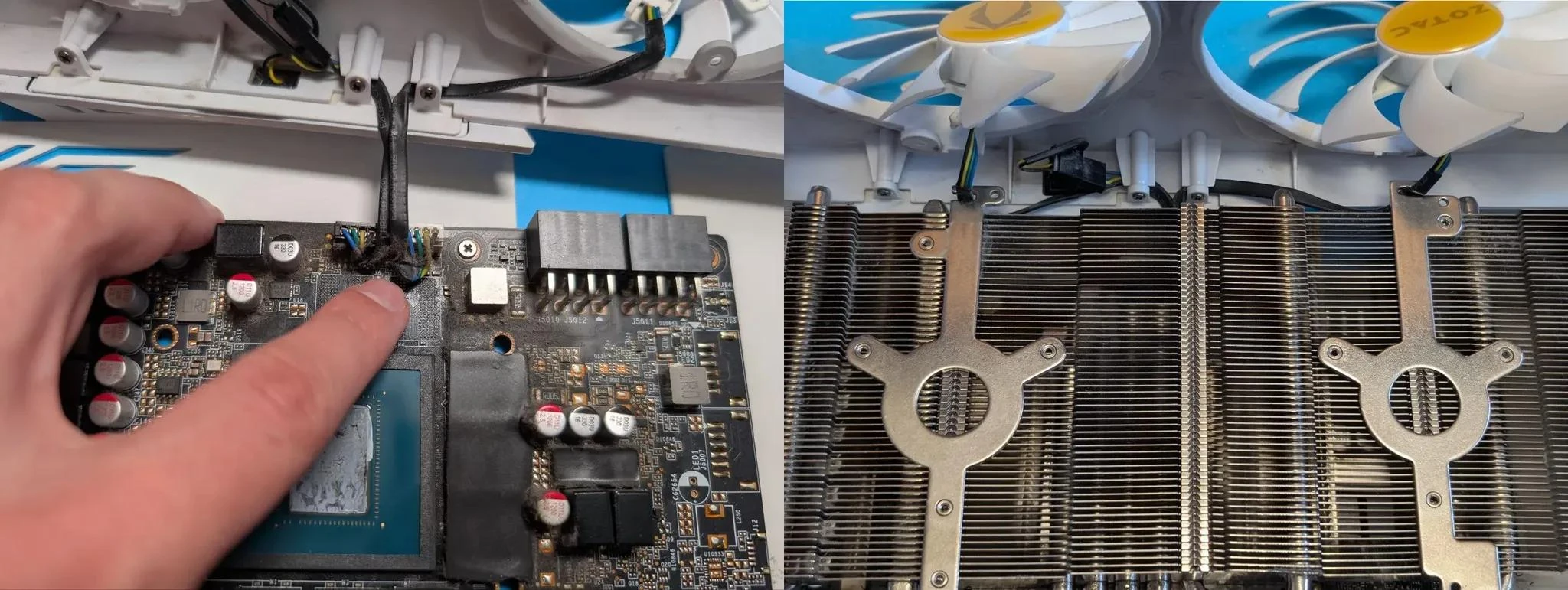

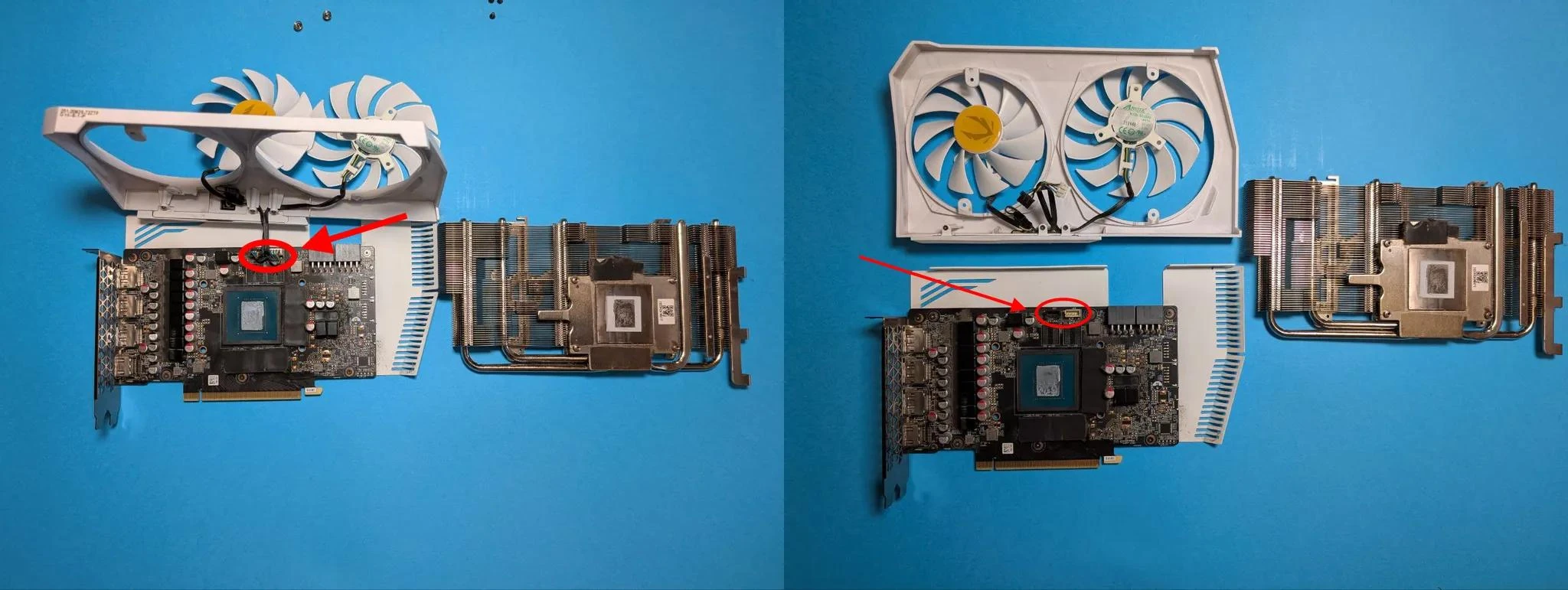

  2. Gently pry off the shroud — watch for clips and fan cables that may be attached.

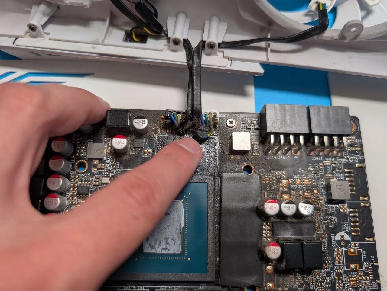

  3. Disconnect the fan cables from the PCB if they are accessible and not blocked by the heatsink.
📸 Take photos at each step to make reassembly easier!
Some models, like the RTX 3070 Gigabyte, may have hidden clips that are difficult to locate—using a plastic pry tool can help.
ASUS Strix GPUs often have long screws securing the shroud—removing them carelessly can damage fan wires, so proceed with caution.

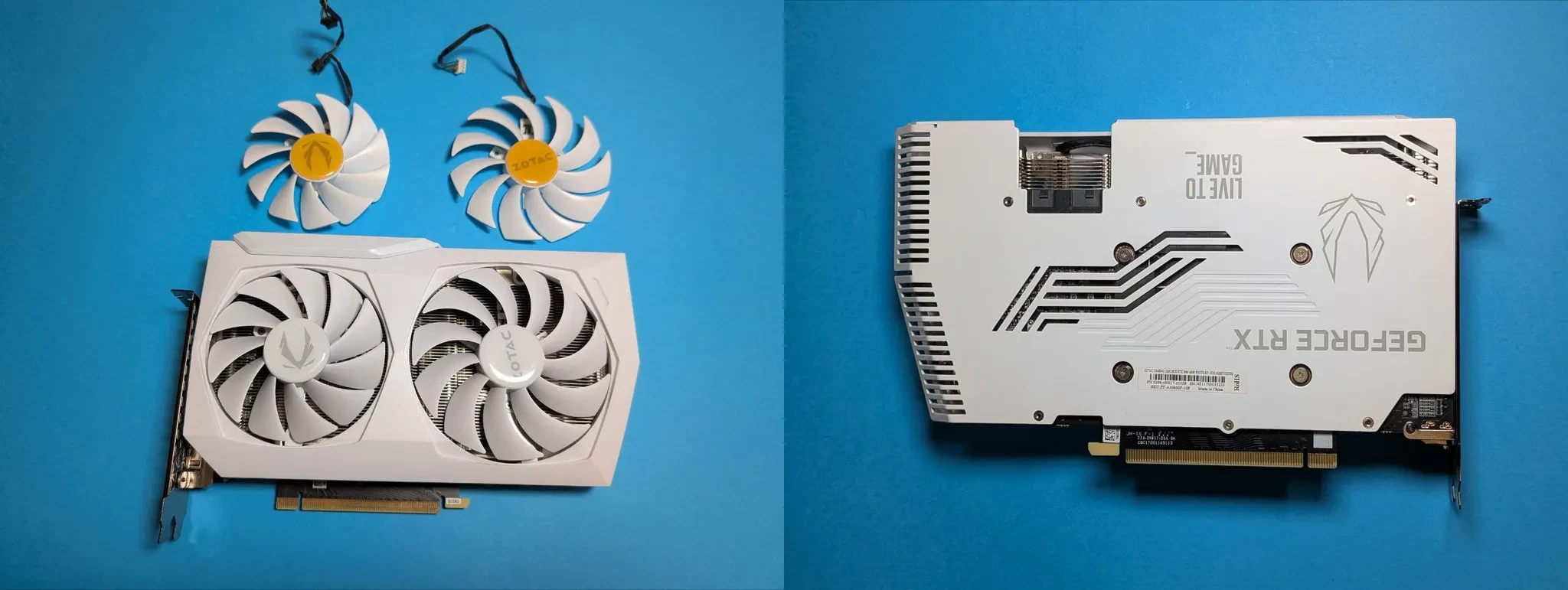

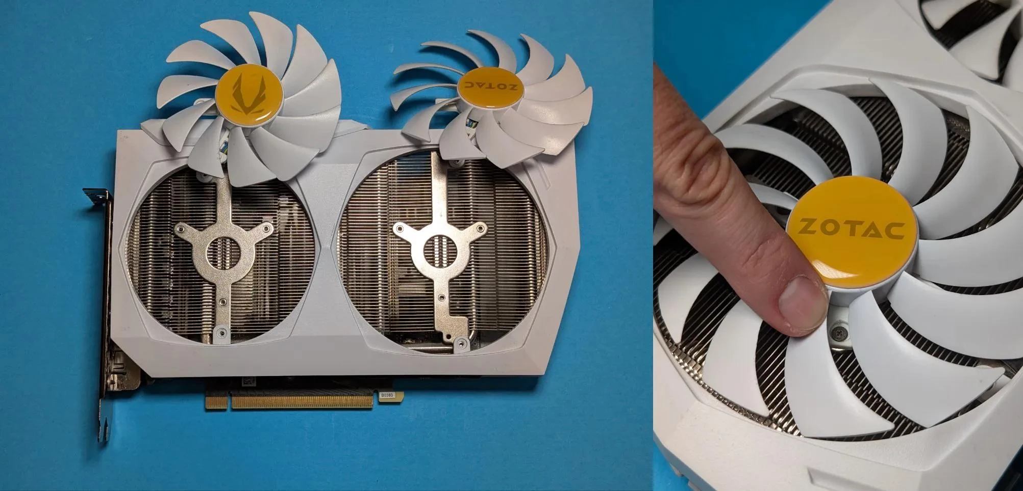

How To Replace GPU Fans
If your fans make grinding noises, clicking sounds, or stop spinning altogether, their bearings are likely worn out, and it's best to replace them entirely.
How to Choose a Replacement Fan
  • Select fans based on your GPU model or the markings on the existing fans.
  • Pay attention to the connector type (2-pin, 3-pin, or 4-pin).
  • Check the diameter, as fans come in different sizes.
How to Unscrew and Replace a Fan
  1. Unscrew the fan mounting bolts — fans are usually attached to the shroud or directly to the heatsink.
  2. Disconnect the fan cable from the PCB.
  3. Install the new fan, reconnect the cable, and secure it in place.
On MSI Gaming X GPUs, fans are connected via a single connector, while on ZOTAC AMP GPUs, each fan has a separate cable.
📌 Make sure to remember the wiring layout and installation order to avoid mix-ups during reassembly.

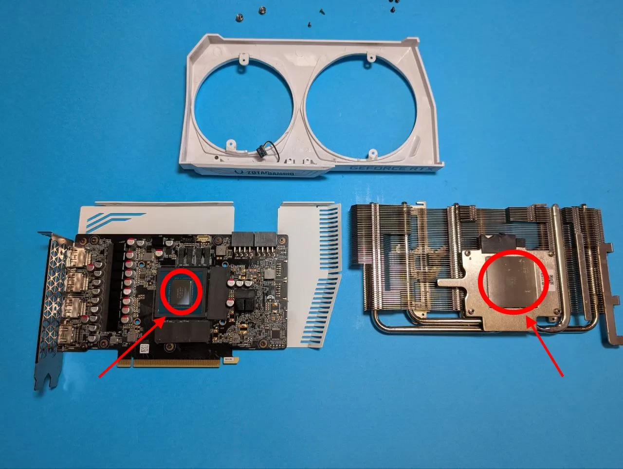

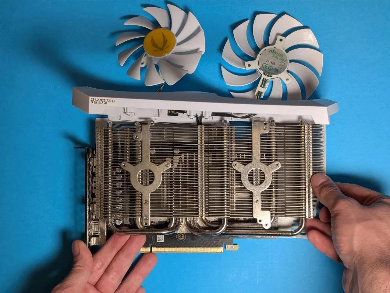

How to Remove a GPU Heatsink
  1. Unscrew the bolts securing the heatsink.
  2. Carefully lift the heatsink — it may be stuck to the thermal paste. Never pull forcefully—this can damage fragile components! Instead, gently rock it side to side until it separates. Preheating the GPU in stress tests before disassembly can make removal easier.
  3. Disconnect all cables attached to the heatsink.
How to Replace Thermal Paste on a Graphics Card
Which Thermal Paste to Choose
  • Arctic MX-4 — A reliable, affordable, and versatile option.
  • Thermal Grizzly Kryonaut — Ideal for maximum performance.
How to Apply It Correctly

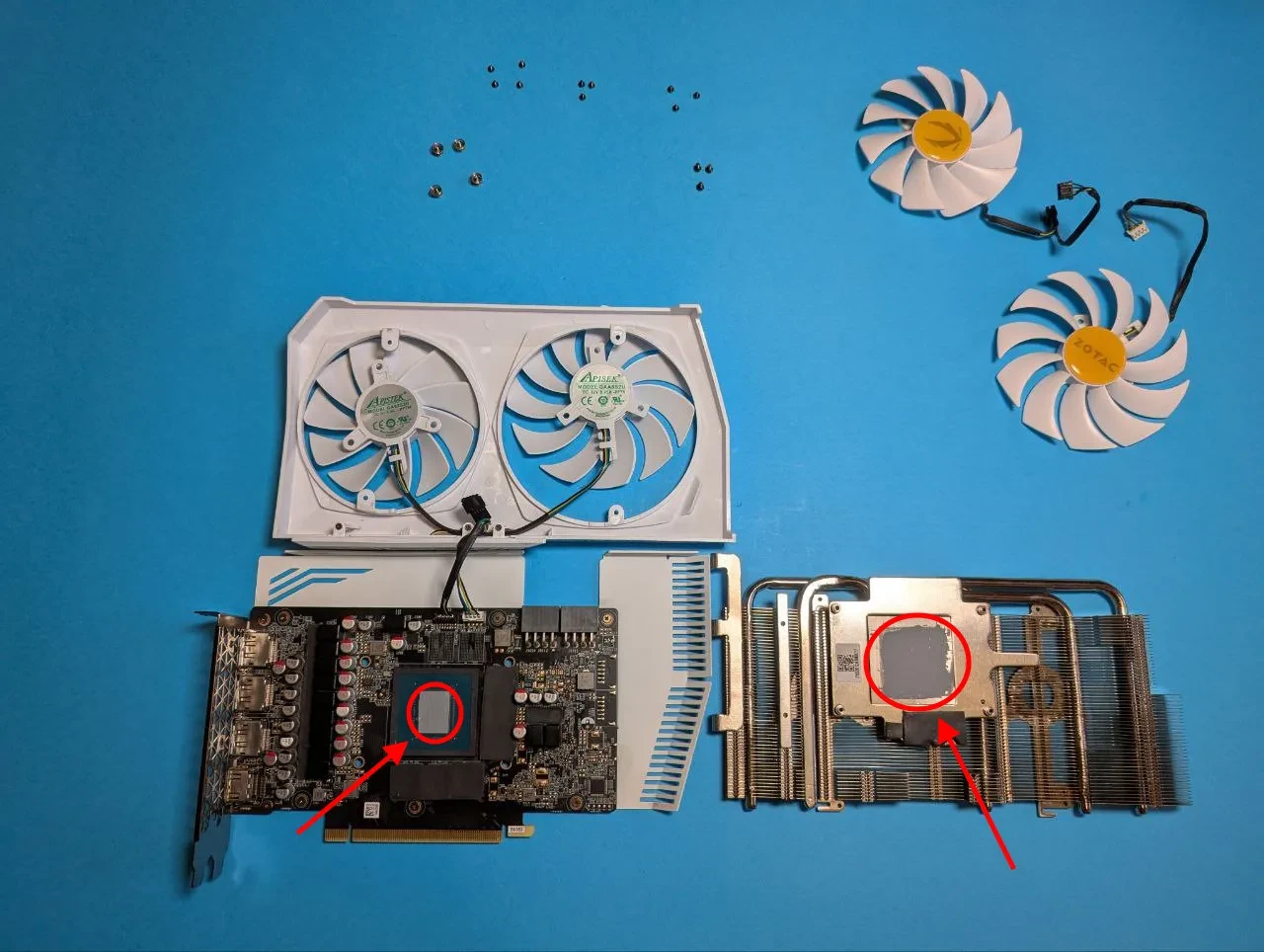

  1. Clean off the old thermal paste from the GPU chip and heatsink using isopropyl alcohol.
  2. Apply a pea-sized drop of thermal paste to the center of the chip. Avoid using too much.
  3. Spread the paste evenly using a spatula or plastic card.
📌 Not confident in spreading it evenly? No worries—the heatsink will naturally distribute the paste when installed.

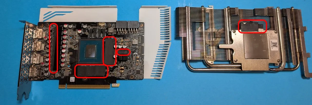

Where Are Thermal Pads Located?
Thermal pads are typically placed on the VRM, memory chips, and sometimes inductors.
How to Replace Thermal Pads
  1. Remove the old pads using tweezers.
  2. Clean the surface with isopropyl alcohol.
  3. Cut new thermal pads to size and carefully place them in position.
