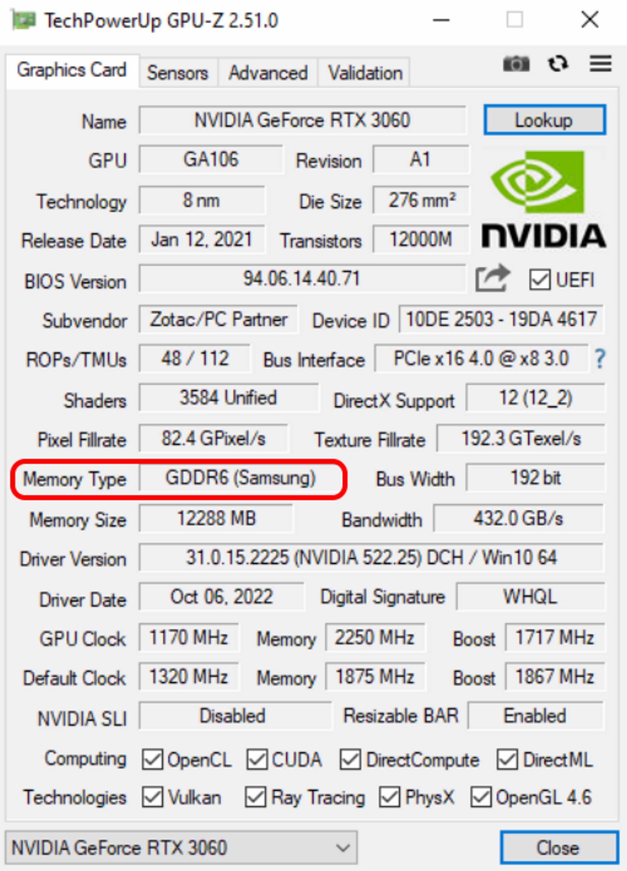

1. Find out the GPU's memory vendor:
Use GPU-Z app to determine the memory type and vendor of your GPU.
Take a look at the memory manufacturer in GPU-Z
Statistically speaking:
  • Samsung may clock as high as +700 MHz;
  • Microns are capable of around +500 MHz;
  • Hynix are the least flexible and stick only with an extra 200-400 MHz.
But there is an exception, such as the Nvidia GTX 1660 Super graphics card. If you come across Hynix memory on a video card of this model, lower the memory frequency to -502. It happened that on GDDR6 memory chips, Hynix memory has better timings at low frequencies.
The real boost is highly dependent on a single chip. Carefully increase your clock speeds to find out the value optimal for your particular setup.

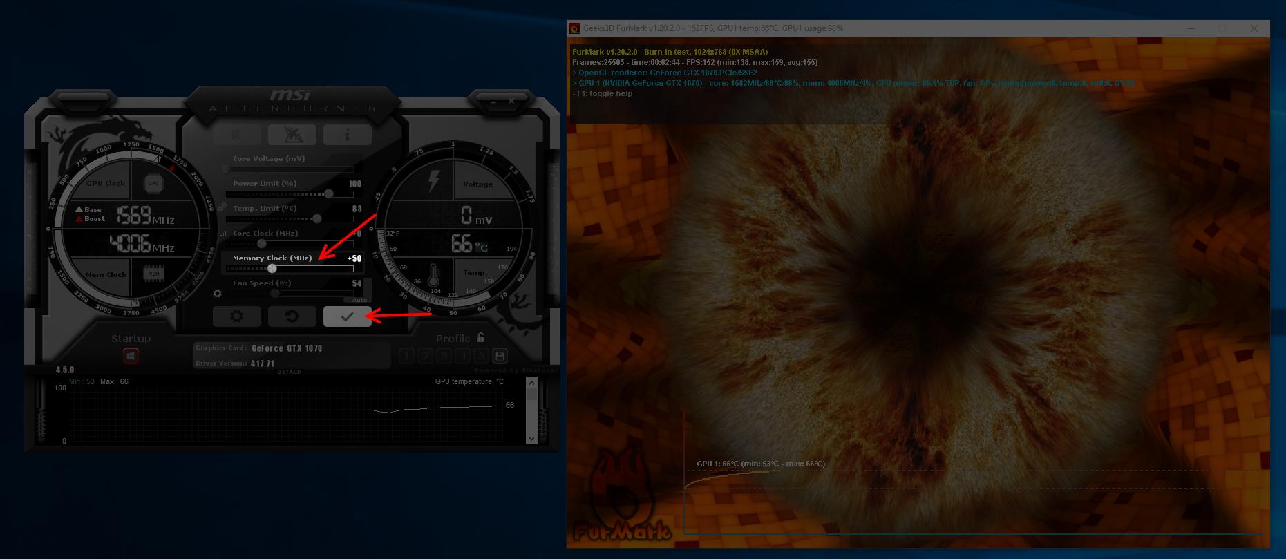

Launch FurMark stress-testing. This app will generate a load that will test the ability of your GPU to endure an overclock.
Run FurMark to check overclock stability
3. Boost the memory clock:
Use MSI Afterburner to overclock your video card. It has a user-friendly interface and works with any Nvidia or AMD GPU.
Overclocking memory using MSI Afterburner
Overclocking should be used with mining disabled!
  1. Launch the MSI Afterburner;
  2. Locate the memory clock slider and start to increase the value progressively. Stick with 50 MHz steps.
  3. Apply the settings and keep monitoring;
  4. Repeat these steps several times. Monitor GPU load and temperature after every adjustment.
